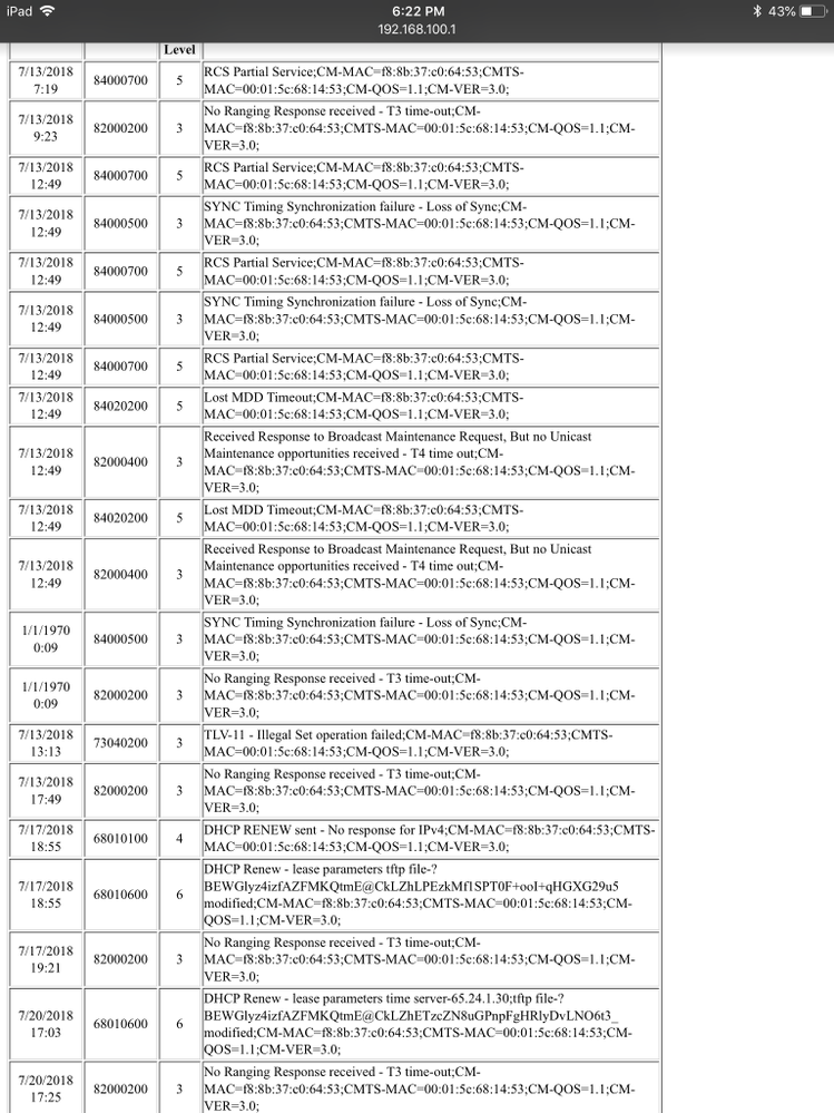

We recently switched from AT&T to spectrum to take advantage of the higher speed internet.  However, I’m experiencing a lot of lag playing Xbox and slow WiFi speeds while streaming or surfing the web.  Unfortunately, the Xbox is on WiFi but the slowness & lag is worse now than it was on AT&Ts 50mbs plan.  I was planning on purchasing a CM600 and switching out the router and possibly set up a MoCA network but still on the fence..  I’ve read some poor reviews on the 1602a so I was going to call the local spectrum store to see if I could swap modems before making a purchase.  Screenshot of modem status:
Is this normal? Any additional info or troubleshooting I can provide or do on my end?

    Event Log:9555D245-CDFE-4CF5-A382-BAF806B67B6C.png

    That's because something is wrong with the cable network in your area.  Specifically, those RCS Partial Service messages mean that your modem is repeatedly losing signal on at least one of the assigned DS (downstream) channels for several seconds at a time.
    Right now you need to call and make an appointment for a visit by a home service tech.  If he can't find the problem inside your home he will probably need to call in the bucket truck cavalry, which may take a couple more days to schedule.

    Just to add...this is not a problem that a new modem will fix.
