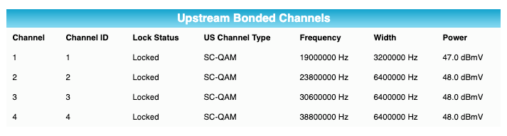

    Your upstream numbers are definitely out of spec. Way too high and you only have one channel locked.  If someone at Spectrum is telling you this is okay you need to find someone else at Spectrum to talk to. What is weird is your down stream numbers seem okay.   Check the coax in your house and make sure everything is good.  But I think you will eventually need to find the right person at Spectrum to get this fixed.

    Your DS and US levels do look like somebody recently added 8 to 10 dB of loss in your drop.  Tis the season for rodents to chew holes in the cable jacket, letting water and losses in.  If TWC or Spectrum ever installed an inline signal amplifier for any reason, be sure its power supply is plugged in and the pilot light is on; if YOU installed one on your own, remove it before the home service tech arrives.

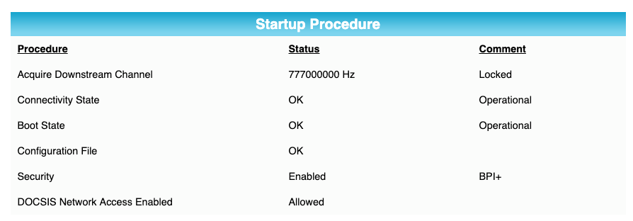

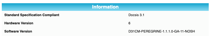

    Thank you guys. An update: I read (elsewhere on this forum) that SB6190 may not be good (and it's also Docsis 3.0, not 3.1). I therefore ordered Arris SB8200 from Amazon and asked Spectrum to move me to it. They did.
    I also bought a different splitter and replaced the one they installed years ago.
    The results of a new test are below. You can see that there are now _multiple_ bonded upstream channels, but the upstream light on the modem is still yellow!
    Any additional ideas?information.pngstartup procedure.pngdownstream.pngupstream.png
  • reds91185reds91185 Posts: 2,452
    Sep 24, 2019
    Are you saying that the Send icon on the front panel is yellow? The manual for this modem only shows green or blue (solid or flashing) as options.  Otherwise, signals look pretty good to me.  Are you still at 300-400 speeds while on the gig tier or are you now getting 800+?
