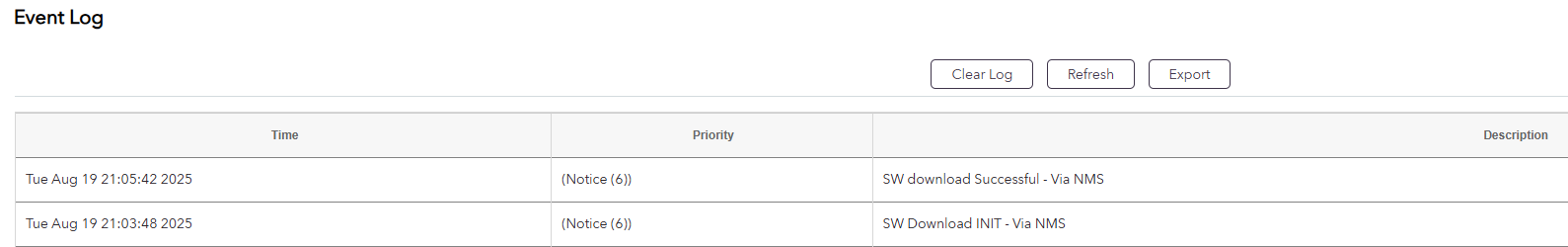

  • jcmars
    jcmars Posts: 4 Spectator
    edited August 2025 Answer ✓
    I have the same modem with the same firmware. Having a similar problem with constant disconnects. It boots, gets internet, and then reboots after it completes a download. The below line shows in logs:
    SW Download INIT - Via NMS
    Then the success…and then the modem reboots itself. Process repeats. Picture of the events for reference. Immediately after the download success - the device reboots and the process repeats.
  • William_M
    William_M Posts: 1,537 ✅ Verified Employee Moderator
    Answer ✓
    Hi @jcmars, welcome to our community. Sorry to see you're having this issue as well. Just to let you know, I've removed your duplicate post about this so please look for responses here.
    @HT_Greenfield good catch! I also saw something similar on reddit. It appears to be impacting multiple (all?) providers, the common factor is the CM3000 modem with v6.01.03 firmware.
    I am working on escalating this to our engineers to see what options are available such as a rollback. My recommendation is to use a Spectrum modem, they are free and more importantly will still work once network evolution/high split is completed in your area.
