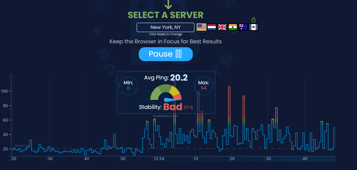

I have ping spikes very randomly. It doesn't matter even if my internet is 100% idle at 2AM at night. I see spikes periodically, sometimes every 10 minutes and sometimes every a few minutes. Any live ping test will show spikes to 80-150 range from a steady 10-25 ping level.

**the screen shot shows 8.8.8.8 pinging but I simultaneously ping various IPs in different directions and spike impacts all results independent from the destination server location.

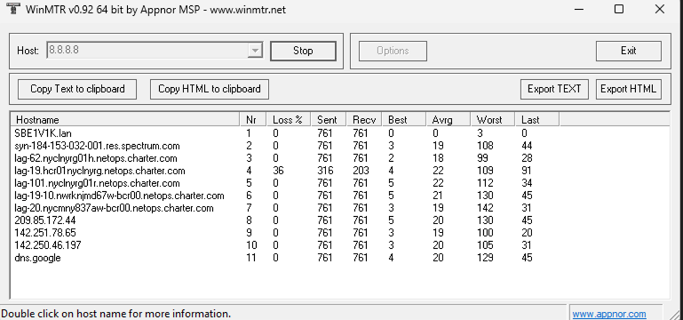

    This is tracert test reading by chatgpt
    • Hop 1<1 ms
      • Your router/gateway. Stable and fine. ✅
    • Hop 2syn-184-153-032-001.res.spectrum.com [184.153.32.1]
      • This is your ISP’s CMTS (Spectrum node).
      • Notice the latency swing: 12 ms → 67 ms → 27 ms.
      • That kind of inconsistency at the first hop after your modem is a red flag.
      • Suggests local node congestion or Puma 7 modem jitter.
    • Hop 3–7 (Spectrum backbone)
      • Several Spectrum core routers (charter.com).
      • You see variation here too (18 ms → 83 ms → 75 ms, then 57 ms → 13 ms → 32 ms).
      • This means the jitter propagates inside Spectrum’s network, not just when leaving for Google.
    • Hops 8–11 (Google’s network)
      • Latency stabilizes (most in the teens/20s).
      • Occasional spike (71 ms), but much less chaotic than earlier hops.
    *Not, I am not sure why it thought my EU2251 modem is PUMA7 chip. I thought it wouldn't be the case.

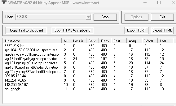

    Even a simple ping test to 8.8.8.8 shows spikes to 80-120ms+ range beginning from hop2. Today particularly this occurring almost every 2-3 minutes and sometimes it lasts a few seconds, sometimes longer. Same results when pinging to various directions.
    This is not just MTR or ping test but impacts my calls with red mic for work or gaming with delays.

    Notice both those reports show 100% delivery at the endpoint... the packets forwarded with some delays (forwarding is one of the router's primary jobs), but the ICMP ECHO replies (an extremely low priority task) were sometimes delayed to the point of timing out.
    What is more important is the stats for the endpoint. Any wonkiness in between onn such a report may give hints at were congestion may be skewing consistency at the endpoint... but the stats at the endpoint may not necessarily be bad, depending if the application has lag compensation or other features built into the transmission protocol in play.

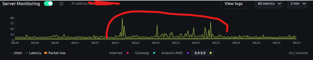

    Thanks. The ping test results are aligned with my online gaming issues or red mic or robotic sound issues in the calls. While many users may not notice this, it impacts my internet service experience badly.
    This is a typical ping tracker to 8.8.8.8 and I ran it while gaming tonight. These spikes are pretty much aligned with the in-game response times. That's why, if ICMP not being prioritized it the problem, so the other things that are technically important for me :)

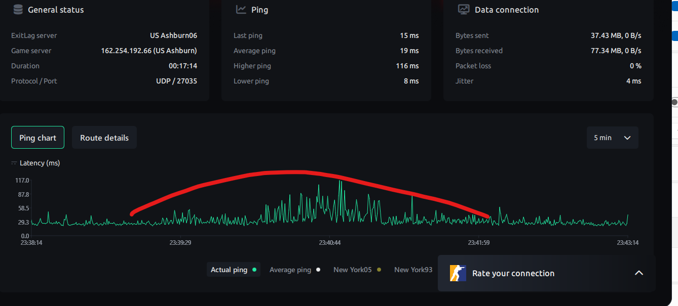

    Regardless of which ping test tool I use, I see the same ping spike patterns. The tech showed up a few days ago and he connected my unit's coax to a completely separate line (can't tell the name but some units share a splitter) and after checking the signals for a few minutes, he said all looking solid.
    I just launched three different games in steam, just to ensure this is not a game server issue and regardless of the title, all games also show a similar ping spikes. I wouldn't mind ping fluctuation from 10ms to 40-50ms but following patterns are definitely not showing a stable connection, ranging up to 150ms.

    This happens very frequently even when I am directly connected to the modem. The ping spikes are aligned with the performance of a game or a call, meaning they are real ping spikes.
