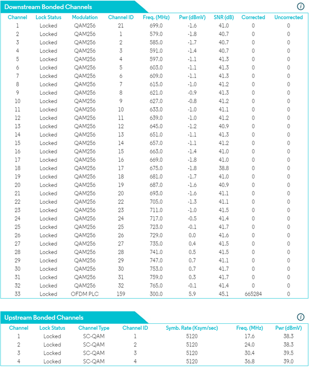

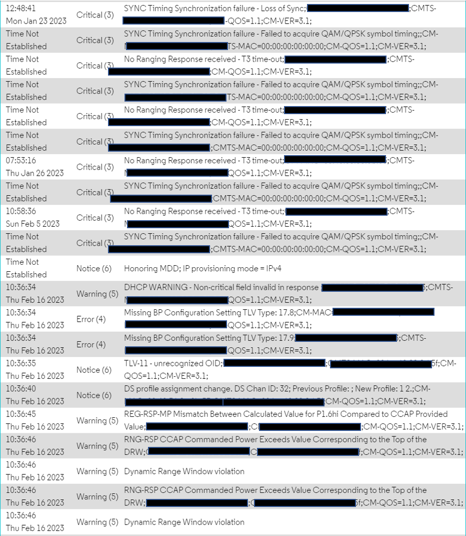

Now we've had several series of drops within the last 2 days and can't seem to isolate the issue, including several drops while I typed this comment. I've attached a current report and the modem error logs with CM-MAC and CMTS-MAC blacked out.

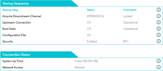

    Sorry for any service issues. L:ooking at the screenshots provided, the screenshots were taken about 4 minutes after restarting the modem, so from a diagnostic POV, there is not much information to go on. I am seeing the brief interruptions that you are describing. We can try sending some refresh signals to the modem and see if that helps, otherwise it does look like you'll need another service call.

    The timing for the restart makes sense, as while I was typing out my comment and pulling the most recent logs, we had an outage and the modem rebooted itself. This is pretty much what's happened I would say 75% of the times we have drops in connection.

    Thanks! Since the modem was recently reset, the reset clears the modem logs and there is currently no log information that stands out. There are still interruptions that can be seen in our diagnostic tool history. At this time, we would suggest scheduling another service call.
