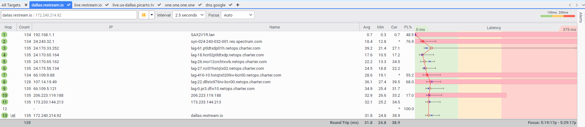

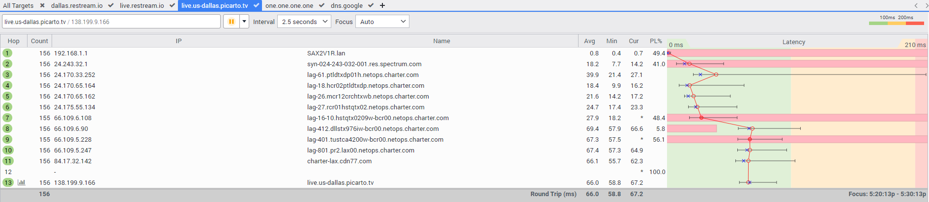

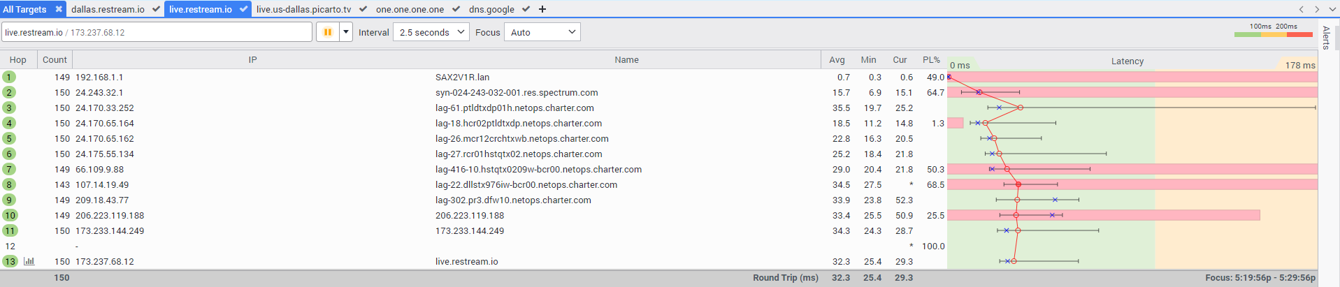

SUMMARY:
I am experiencing severe outbound packet loss disrupting my live-streaming traffic. I have isolated the issue using concurrent PingPlotter traces. Traces to Anycast DNS (8.8.8.8) are clean, but traces to Dallas-based media ingest servers (Restream and Picarto) show consistent packet loss originating on intermediate edge nodes ending in spectrum.com / charter.com.
Because this loss is localized strictly to these routes and occurs entirely within the Spectrum core network prior to the handoff, this is an internal Spectrum routing or peering capacity issue on the path to these destination ASNs (Autonomous System Numbers). Please escalate this traceroute data to your Network Engineering/NOC team to review the outbound transit paths for these routes.
I have swapped out my old Spectrum router for the latest model and configured that earlier this week. I've already been on the phone with support and escalated it as high up as they are allowed to take me, so now that I've jumped through the hoops and confirmed that the issue is not with my home network or its equipment (negating that Hop 1, the router itself, commonly deprioritizes ping requests so I am ignoring the packet loss there) hopefully this can be looked at.

    Your traceroutes all show you are getting 0% packet loss. It's not just your router that can depriotize ping requests, any hop can. When interpreting traceroute results we are looking for a problem like packet loss or high ping that starts at some point and persists on every hop after including the destination server. You can see my write up about this. Do you get your full speeds when running a speed test? Can you elaborate on exactly what issues you encounter when streaming?

    I'm a bit confused as to what the red bars and PL% markings mean then, as I know that points noted with an asterisk mean that the connection timed out and had to retry. Those jumps show up as three individual asterisks on a tracert done via Command Prompt too, PingPlotter just lets me continue running them and get a rolling average. The connection does seem to eventually go through.
    What happens, and I've confirmed this on two separate systems (one Windows 10, and one Ubuntu) that the stream (via OBS, at ~3.2Kbps and an audio bitrate of 128 - so barely 720p) will hiccup just long enough for the connection to Restream/Picarto to register the broadcast as offline for a split second, because as soon as the "Disconnected from server" dialog box disappears it's immediately replaced by the "Connection reestablished" one. It doesn't stay off, it just blips long enough for everyone to need to refresh their browsers to see it again. Happens every 20 to 40 minutes.
    If the servers/gateways are deprioritizing ping requests I suppose that's an explanation for it, but I'm not certain why connections to multiple different servers on different businesses would experience near identical issues.
    Speedtest results seem fine? I am grandfathered in on the lowest rung Affordable Connectivity Act plan because even the most basic plan has the same upload speed as the next two tiers up. I literally do not do anything online other than stream games or drawings. I don't watch anything, I don't have any subscriptions to Netflix/Hulu/Disney, I don't play any online games etc.
    The problems started just after the storms we had around Corpus Christi, TX a few weeks ago. Since then, every Friday (the only day I stream) the interruptions happen constantly. Tonight I routed everything through ProtonVPN to avoid Spectrum's infrastructure and there were a few dropped frames (<0.5%) as a result of the artificial bottleneck by the VPN but I had zero issues with disconnects & interruptions.

    They are individual hops which are not consistently replying to your ping requests. Yes, we know it is just ping deprioritization because the following hops (including the final one at the destination) are not showing that same amount of packet loss. This is completely normal and will be seen on most traceroutes even if there are no problems. If you were actually getting 50%+ packet loss the problems would be much worse, if you could even connect at all.
    If you run just a normal ping test (In a Windows command prompt enter "ping live.restream.io -t" and leave it running for a few minutes, then use Ctrl+C to end the test) do you get any packet loss? What if you ping a different server like 8.8.8.8? Do you have any problems using the internet outside of streaming? When you said your Speedtest results seem fine, did you mean you consistently get your full upload speed? Have you tried streaming to a single service instead of going through restream?
