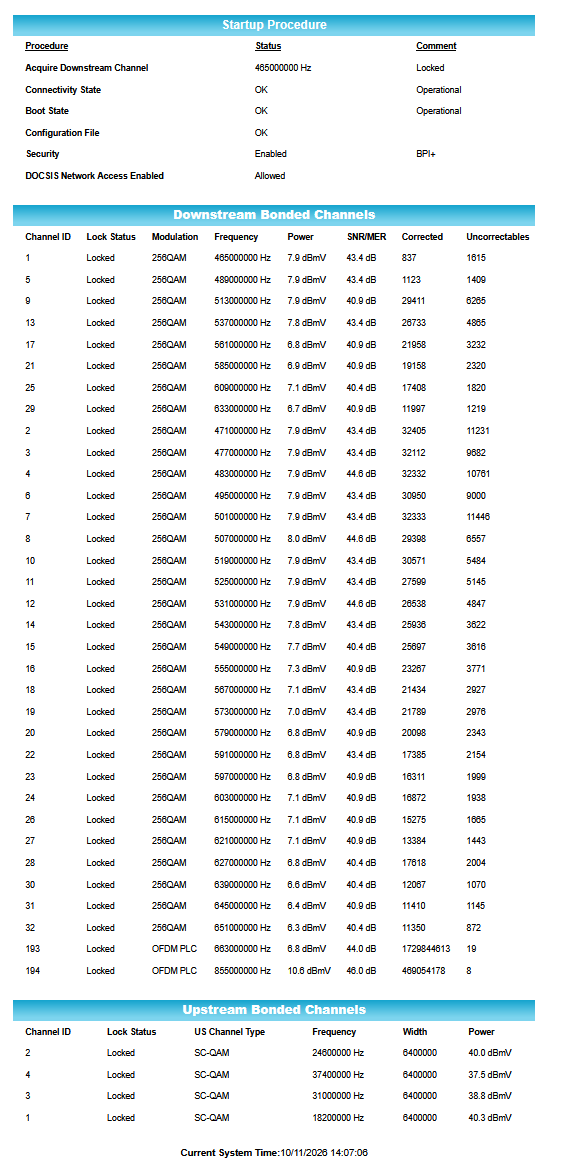

    Signals are still pretty good, though the number of errors continues climbing:
    Someone has already been out to my house and said the signal is good, and we're seeing the same problem at the neighbor's. Can anyone help?
